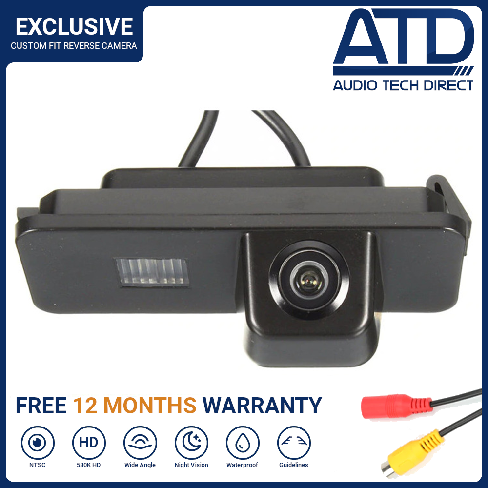

I have a new rcd360 fitted in and want to include a reverse cam
Does anyone know how to install a reverse camera that's designed in a rear number plate light module.(comes with its own light in the module) ?
This is the product: https://shorturl.at/gjuIU
[media]https://i.ebayimg.com/images/g/Nj0AAOSw ... -l1600.png[/media]
This module fits perfectly in the slot however Im not sure how to install it as it's only possible to remove the rear number plate light bulb holder from the housing only and not the whole thing so that i can access just the power cables (red and black ones)
Is there a way to separate the light bulb and its holder I can wire it up with the new module that includes the camera?
Cheers

The number plate light and the bulb/bulb holder separate from each other. You should be able to twist the base of the bulb holder and it will release from the light unit. The bulb also disconnects from the bumper loom.
I have just fitted almost exactly the same camera unit.. it needed a little bit of filing of the edge of the hole for it to fit properly, but that could just be my bumper moulding (it's not an original).
I bought a conversion loom to connect to the back of my head unit (the later Discover Media Nav), then it was a case of enable the r ar view camera and backup camera options in VCDS, and I now have camera overlay working.
