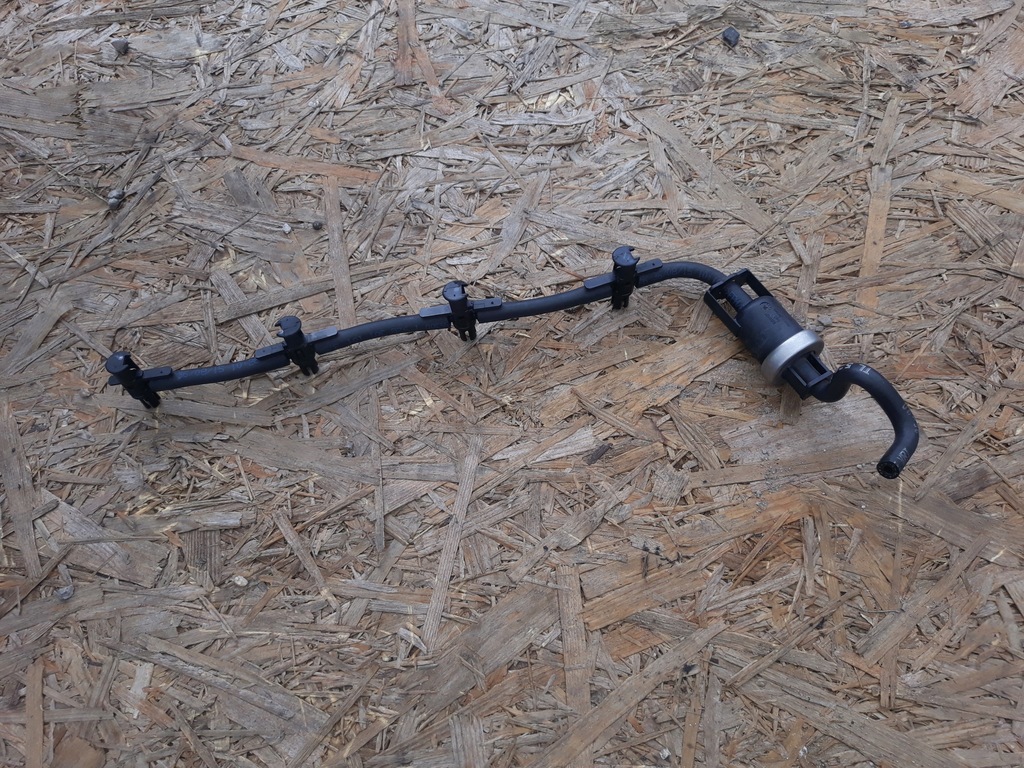

Hi, yes it's in the main line that return fuel back to the fuel filter. Must be somewhere around the engine.
What you can do is prime the fuel system a couple times with vcds when the car has been standing still some days and see if it makes a difference.
https://workshop-manuals.com/volkswagen ... el_system/
https://a.allegroimg.com/s1024/0c36ef/7 ... d0c33f6bb0

Thanks for that info. I didn't find such a diagram in the Scirocco Workshop manual but will look again. Now that I know what I am looking for I will have a better look under the bonnet. I found the attached item on Google under Scirocco pressure control valve but not sure if it is the same item as it does not appear like the one you have shown. I had thought of trying the priming option in VCDS but as the engine runs faultlessly once it starts or is restarted within a day I wasn't sure if priming would help - seems to me more like a possible leak leading to a drain back or a tiny leak in a one way valve or O ring but will keep looking!

Yes it's in the workshop manual page 225. It's just above the valve cover on the right. Looks like a rubber grommet.
The valve in your picture is the high pressure fuel rail pressure regulator. This could also be leaking yes but i think your car will run horrible if it does.
I believe you it runs fine once it starts but you want to pinpoint your problem.
You can run both fuel pumps in engine basic settings channel 035.
Or connect a pressure sensor in the fuel return line from the injectors back to the low pressure fuel system so you can see what it does after a couple days.
