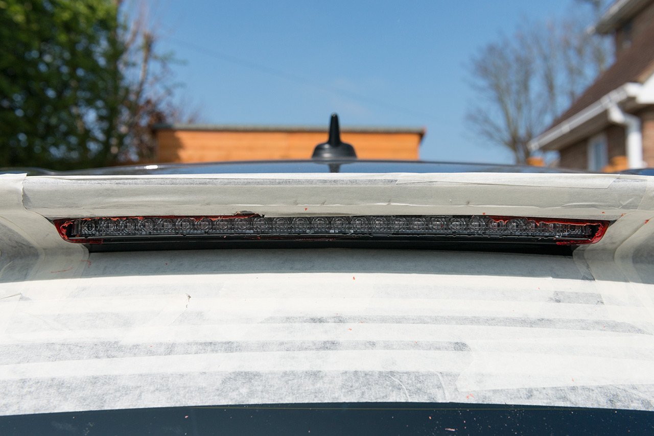

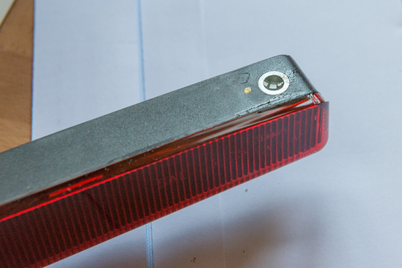

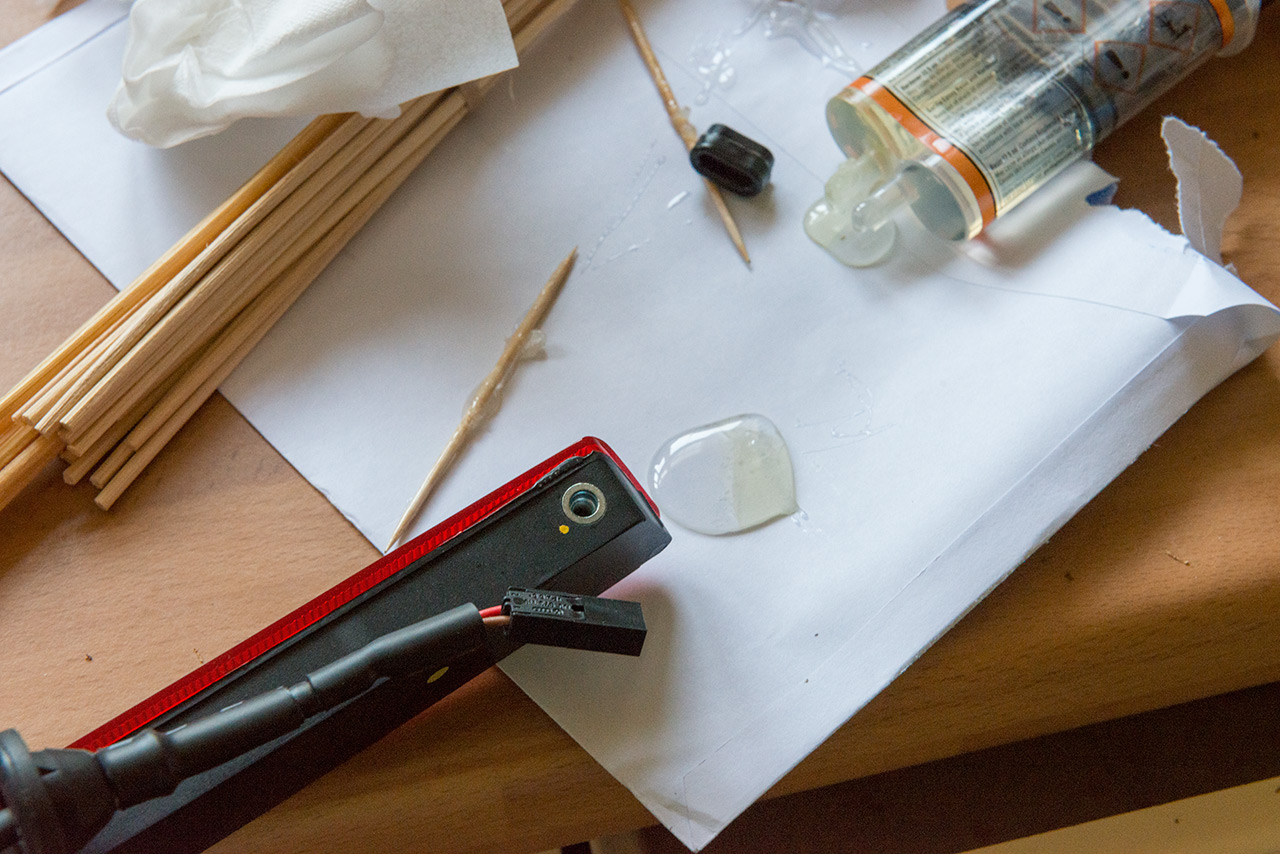

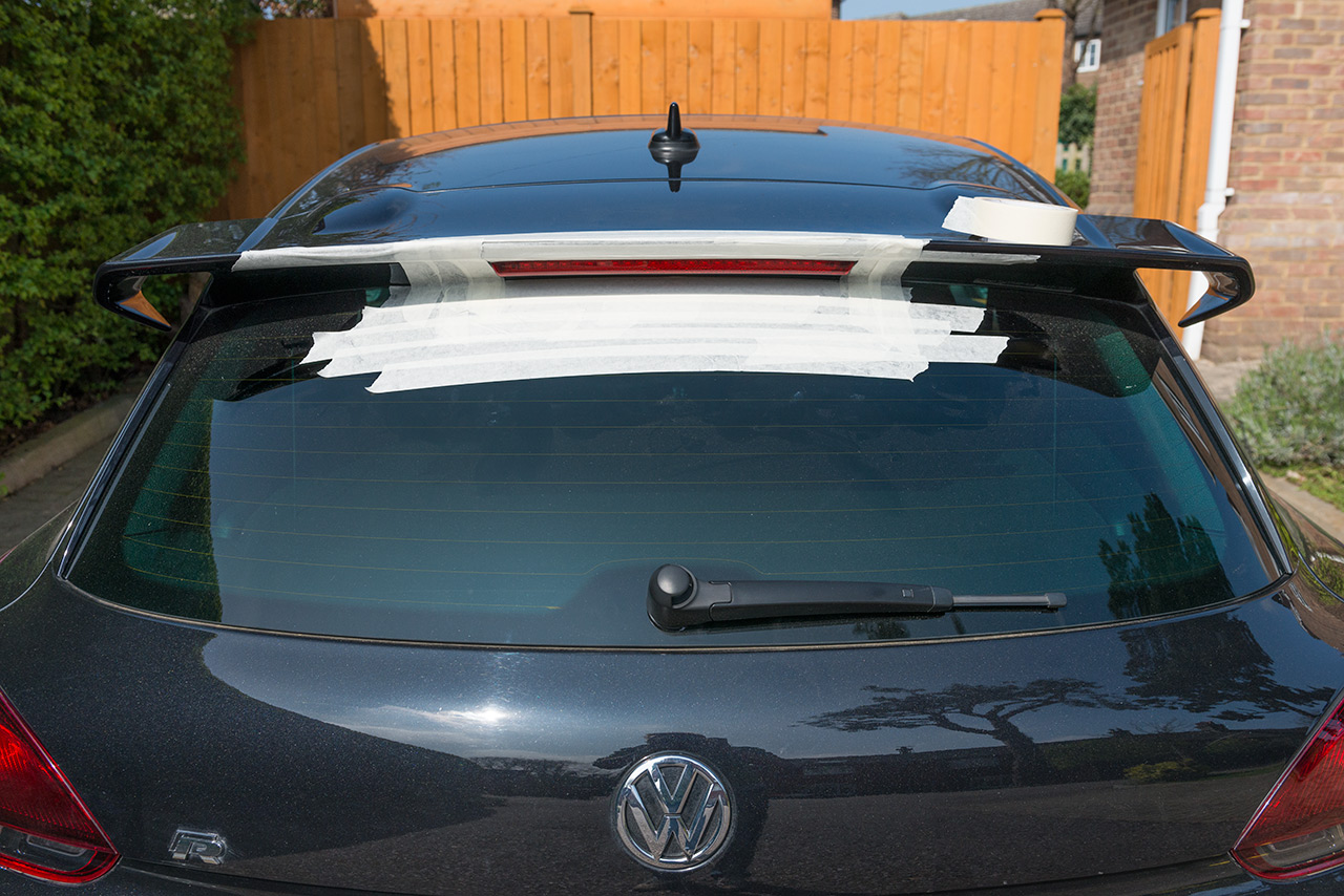

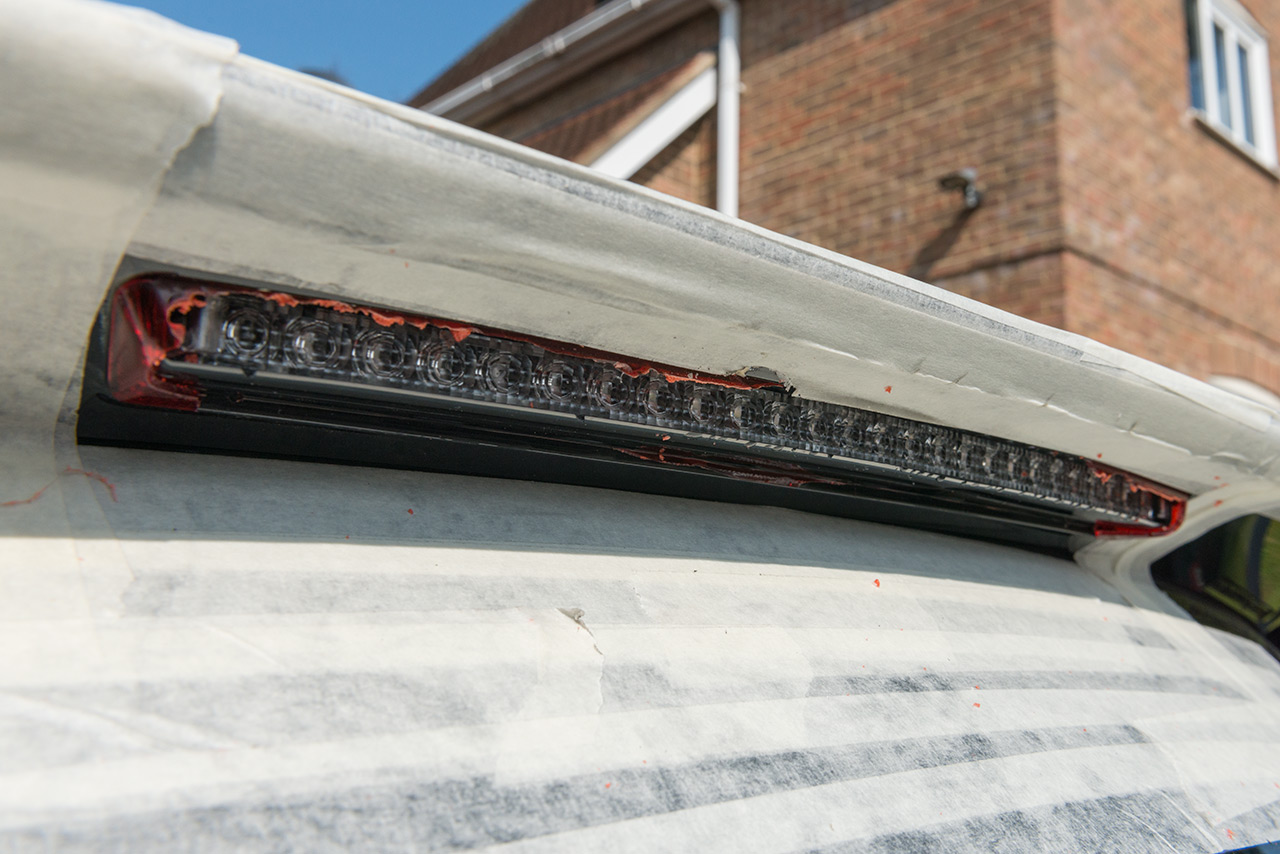

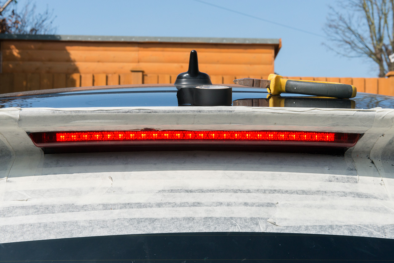

1. prep everything - tools out, double check you have everything you may need, cos once it's out you can't drive it anywhere till it's fixed... hmm. mask off around the spoiler
2. using a dremel, CAREFULLY drill round the edge of the red lens to get to the led rack behind. don't go too near the edges or corners - yet.

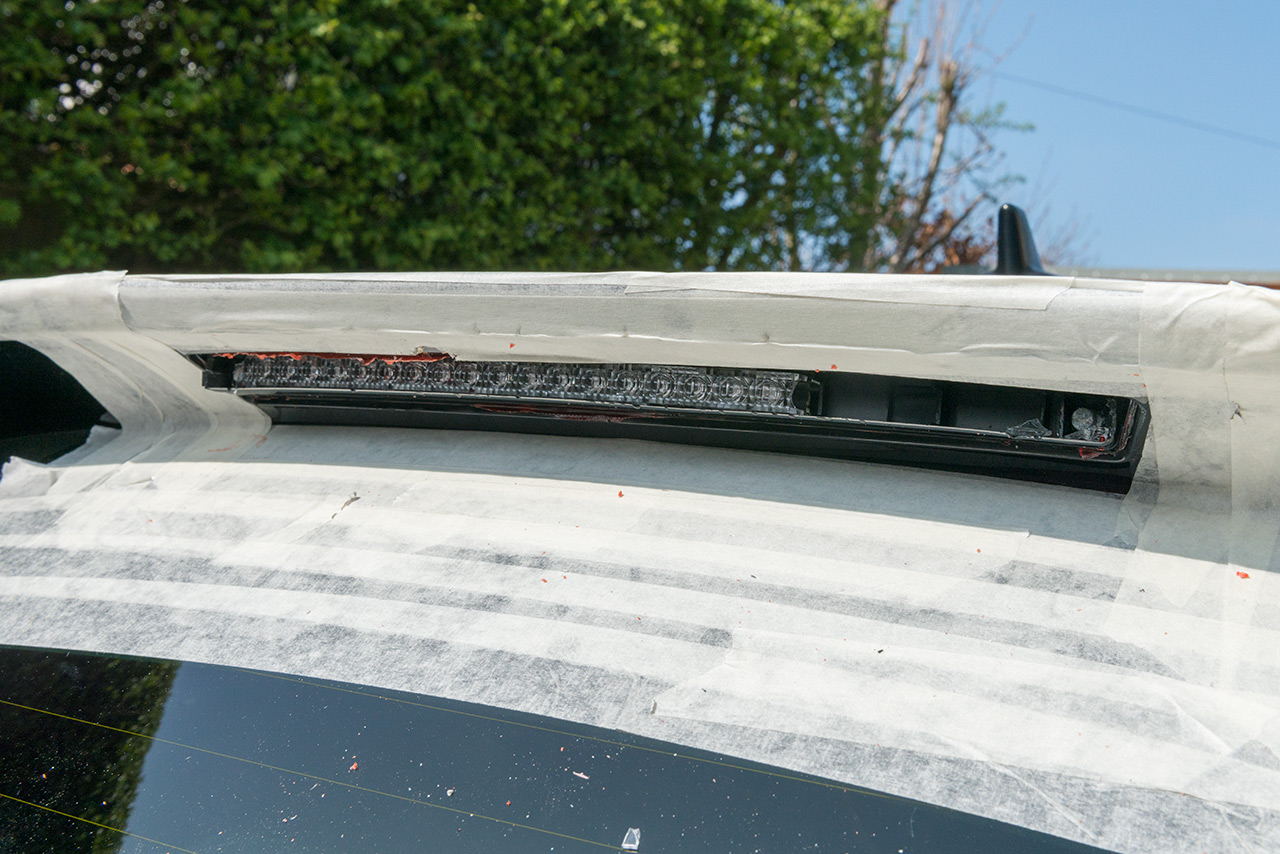

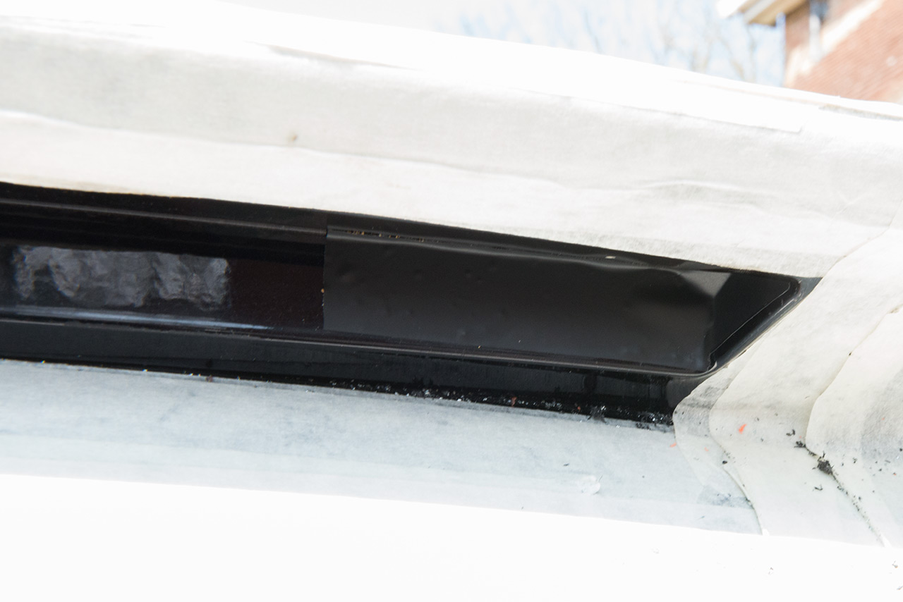

3. concentrate on once side at a time, chip out the led rack

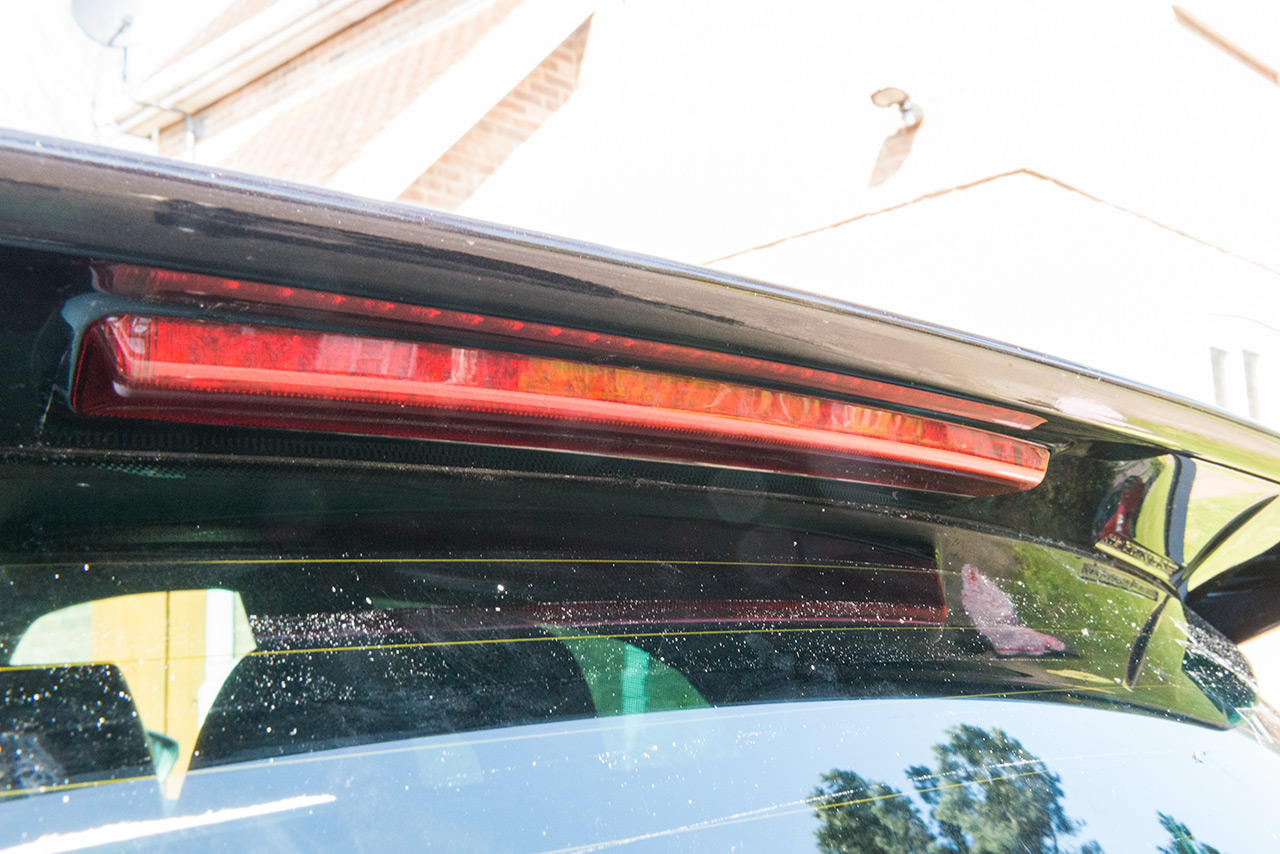

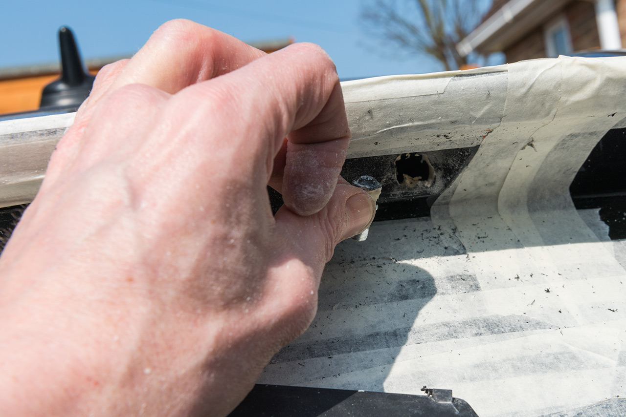

4. the screws that hold the
light in place are on the far edges. these have to be cut out. don't drop them inside the spoiler!

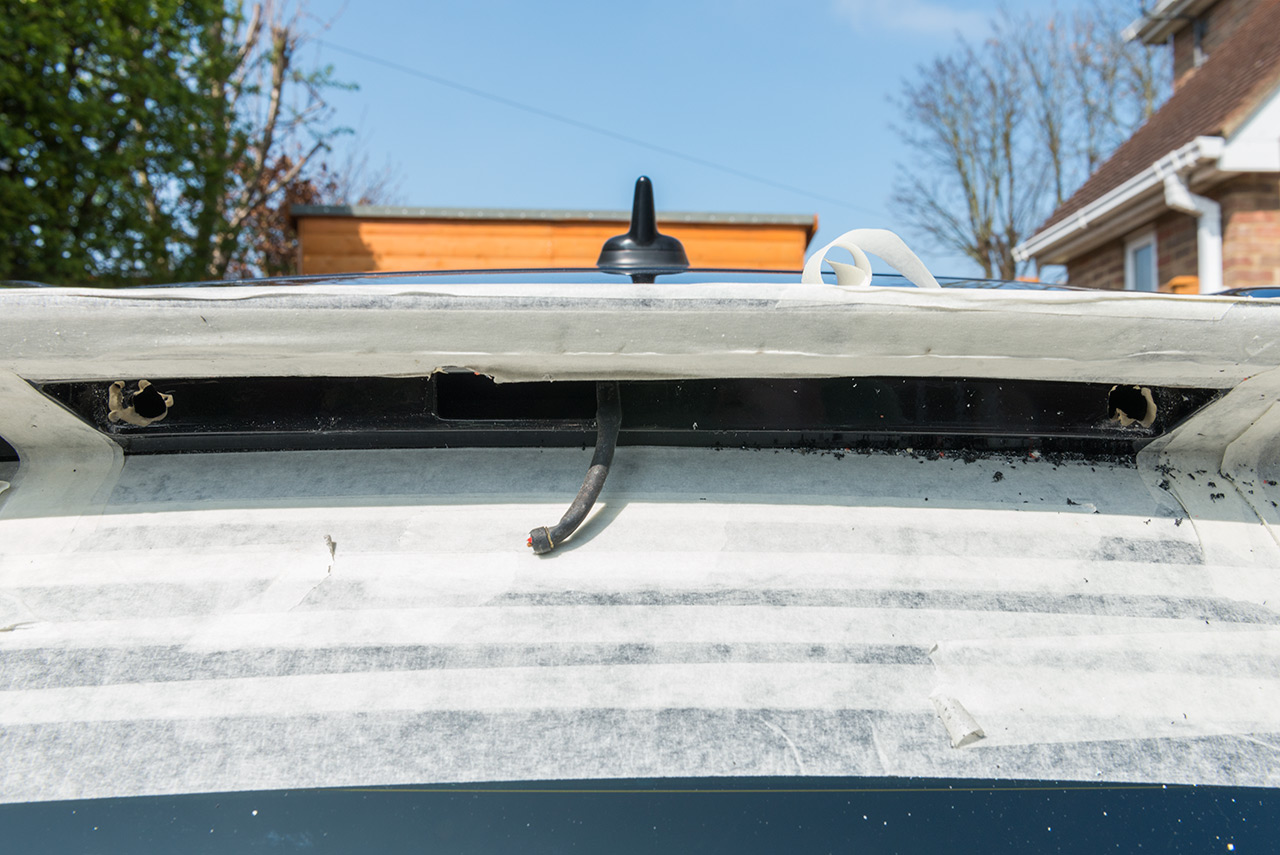

5. wiggle the
light past the clip in the middle on the top holding it in. cut off the
light from the cable, leaving as much cable free as possible.
