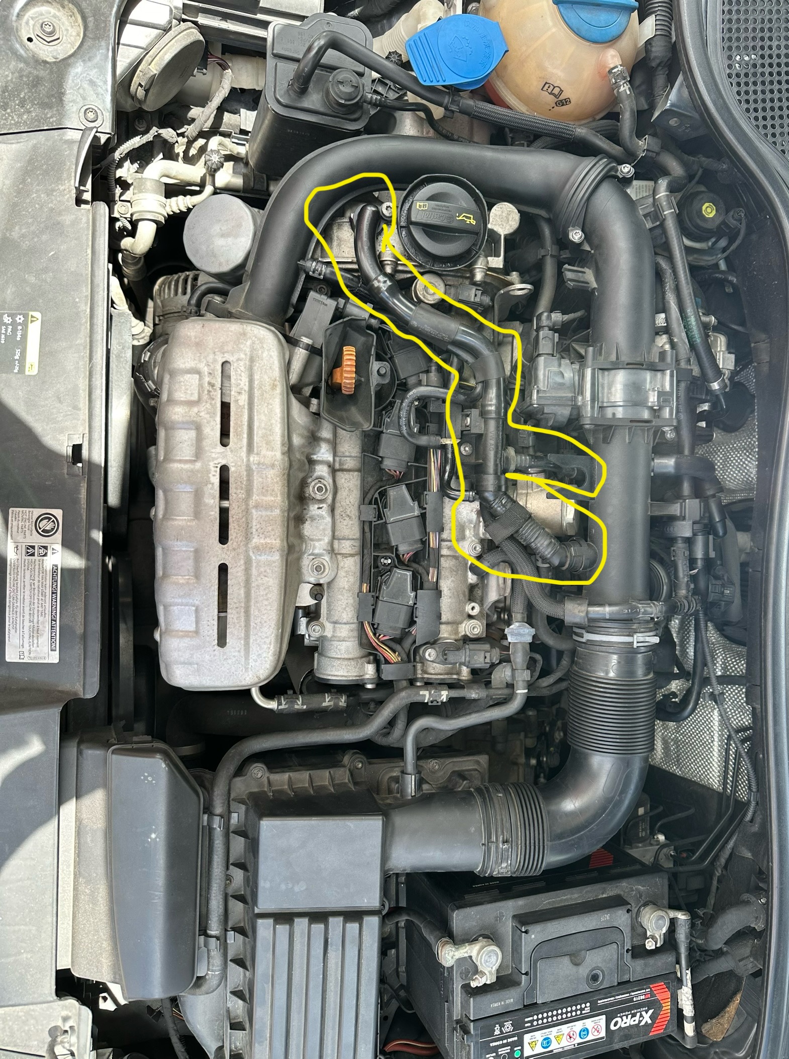

I found this one way valve is not working properly and I change it. But didn’t solve my problem, only feel more smooth when the gear change from 1 to 2.

One way to check the pcv valve. While the engine is running remove the oil filler cap. You should feel suction while lifting the cap off if the cap comes off without feeling suction then you know you pcv valve has failed.

I changed PCV valve, waste gate solenoid.
But it’s still no power when accelerating
