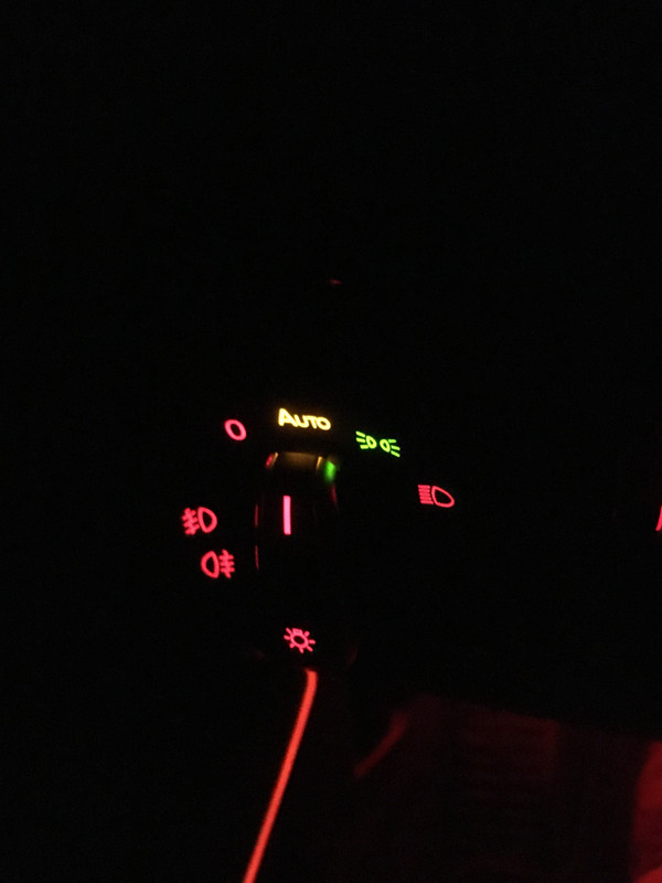

For info, here's the switch I have

There's something not right about that headlight switch as it looks as though it only has a rear fog light setting. With the cars with front fog lights you pull it once for front fogs and twice for front and rear fogs. The legend on the switch only has one fog light setting.
Are you sure someone hasn't wired them up as DRLs. Have you checked whether they are on when the engine is running?

I think you're right i also have 2 fog symbols on the bottom left side front and rear.

Hi Jeff, that's the rear fog switch.

Those are the standard fog lights in the pre-facelift models. As Cuprabob says: the switch usually has two fog light symbols and pulls out two clicks to turn on both front and rear (the switch has to be turned to headlights first. Doesn’t work on auto). Is the switch photo of your car, or an image you found online? If it’s your switch then there’s something odd going on.

Here are the wiring diagrams, think the easiest way is to check if the lights are wired.
If this is the case you only need to change the light switch and enable front fog lights with vcds.
Go to module 09 cent. electronics long coding byte 14 and check bit 0 front fog lights installed and save.
